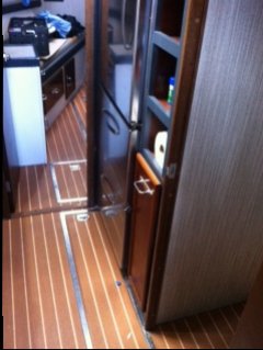

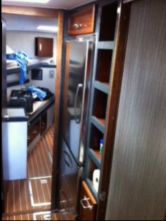

    I put a virtrifrigo in ,it has a frezzer drawer,refrigerator drawer and the top 1/2 opens like a regular frig, it's awesome ,I am in the process of putting a cheap 2 cubic ft bait freezer in the forward state room closet

    I had an apartment size in prior to putting the ew one in ,you really need a counter depth refrigerator or built in because tha tally is so narrow ,I built a cabinet around the vitrifrigo
