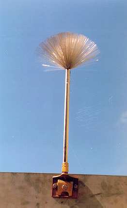

    Forty years ago after hearing about these from a guy with a "stick" boat down the canal I bolted one to the top of the Tuna Tower on my Bertram here in S. Florida. His mast had previously been hit. Fifteen years later he sold his home and went sailing round the planet and settled in Ha. About a dozen years ago I started to notice them on FPL pole electric equipment all over Broward County & on all of the Counties Traffic CAMS. Do they work? I've heard all the arguments & all I can attest is I never had any lightning issues up to the sale of the boat a few weeks ago.

    You'd think that by now someone would have filled a field with telephone poles and mounted various lighting rod systems and recorded the results.

    Now there's a use for the many old condemned ATT Poles they've been dragging their asses for years in removing but the environmentalists would howl so loud they'd be heard across the big pond if the "field" was in the Glades. The cost of dry land now well over 7 figures per acre down here but that would be a more worthwhile study then many we hear the government funds. Should be able to find out how the little fuzzy things have been doing in protecting the many road cam's in this county, although I have reason to believe many of them, for whatever the reasons, either don't work, no one pays attention to them, or they were fake to begin with.
