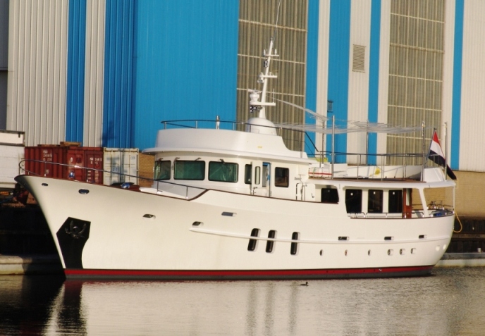

    Feadship Sultana, 3 years has past when I found her in miserable condition and we are now entering the final stage of her make over session
    She is finally afloat, 42 years ago baptised by the famous yacht builders family De Vries who gave her live back in 1969.
    It brought her good luck.
    The 25th of February 2012, again baptised by the same De Vries family, hoping that her luck will continue.
    Here the christening of Sultana : video: Launch Christening Feadship Sultana.mp4 - YouTube
    Slowly she comes to live, all systems are started and tested one by one.
    Most important first off course: one fridge and one icemaker are up and running…..
    Next the old rebuild Gardner engines, a shiver of live went through Sultana when they were started..
    See here engine startup: 15 02 2012 first engine start Feadship Sultana.mp4 - YouTube
    if all goes well according to plan, sea trials will start soon.
    When all is checked, adjusted and double checked, we will return to the Azure blue waters of the South of France where she has spend the majority of her 42 years.
    And again, she will gain the harts of people who love classic yachts for another 42 years.
    This time only with the most modern comfort on board available.
    Sultana has reborn, a old lady without any trace that she is old.
    Everything is new, except her appearance and soul.
    Most important, she will be far more respectful to the sea and her natural environment then ever before.
    Here a video of before and after: Classic Feadship Sultana old and new impression - YouTube
    No it is her turn to get to work, nothing comes for free.
    She will be available for charter guests and do her best to make them feel proud, comfortable and assure that they will experience a unforgettable time.
    Sultana and I have had a fantastic few years together. it was a great time and we know that the next chapter of adventure will start soon.
    We plan to pamper people, live adventures, get to know the seaworld even more.
    here a few impressions of the past few years:
    http://https://picasaweb.google.com/feadship.sultana
    Hope that you have enjoyed what you have seen…
    Best regards..
    Kees van den Hoek

    feadship Sultana rebuild
    You're right..
    It was a tight budget to start off with.
    However, while rebuilding idea's came up... many idea's..
    Idea to make her as fuel efficient as possible with the old Gardners in place.
    "Old" is often not at all fuel efficient.. but, we managed an average fuel consumption of 33 ltrs total both engines over 2500 miles... between 9 and 10 knots ! And... all the way fairly heavy sea's against us.
    900 rpm !!
    Try that with a "modern" engine at 1800 rpm..
    The system does not need any genset running while underway, one gardner delivers all electricity needed to run all systems DC and AC..and even charge the 40 x 200 amps batteries.
    These batteries allow us 12 hours silent running..
    No genset while at anchor..
    Still, airco and all other needed systems running.
    We use the genset only when we can use her nominal power output.
    My experience is, that if a genset is used at her rated power, it will last many thousands of hours.
    And, we can choose the timing....
    So, no genset when: sleeping, swimming, dining, evenings. But, when the guests are on the topdeck, or out for exploring etc...
    A yacht is built for people in my opinion, it shouldn't disturb people....
    The genset is only absolutely needed while using the 380 volts bowthruster at 100%.
    At 50% the converters can handle it on their own.
    Sultana has so much top deck living space never seen on a classic and "small" yacht.
    Forcing the tenders to go on the foredeck...
    Great decision.. just the weight !!
    To counter act the weight, I fitted a bulbeous bow... Many were against..
    But, one knot extra topspeed, and enough to counter act the extra weight on the foredeck and much better sea keeping while against the seas..
    Very much unexpected advantages....
    Best decision ever !!
    saving money on the long run...
    ( and.. we can follow the dolphins on all tv sets/monitors with the camera fitted in the bow )
    She is packed with exteremely simple inventions...
    Toilet system that is silent, no pumps, macerators.. just very big, big pipes..and one 380V/5HP super marcerator in the holding tank.
    Enough of repairing pumps that holds stuff that wasn't eaten before !!
    "yacht" pumps are often toys, built for the "after sale" department.
    Saving money on the long run...
    All heat is recovered, as well engines as genset.
    The genset can even preheat the Gardners in 20 minutes.
    While underway, hot water production is free of charge.
    Ships heating and boilers.
    220 liters of hot water, everybody can shower at the same time, no temperature dips... no lack of it.
    minus 10 degrees exterior in Holland, 20 minutes, and the interior is at 22 degrees.
    And again.. if the electric or diesel heater doesn't work, we can still produce...
    Maintenance and repair reduction to the maximum...
    High end electronic monitoring of the Gardners.. we repair or maintain when needed, not after X hours..
    Repairs can be avoided, we know when something starts to go wrong well in advance.
    back up systems..
    Sultana can run without any electricity at all....
    Even manually start the engines...and still fully control them from the bridge.
    4 alternators for charging.. if one is lost, the cruise goes on, 2 lost..the same...all lost..start the genset.. or vice versa.
    Fuel systems the same, double filters, vacuum meters, changing filters while running without the need to bleed !!! 10 minutes per filter..
    All filters the same model, running out? take the one from the diesel heater !
    or just filter our own fuel tanks with the transfer pump if needed....
    We don't want to loose charters because of technical trouble.
    However, Sultana became unique in her concept, old and new married.
    Comfort,space and technology of a brand new yacht, ... packed in a old lady with style, a story and proofen history..
    Yes, it was more expensive then planned..
    But... Sultana will be able to pay it back on the long run.
    We had a great trip from Holland to Monaco.. minor tune up problems..
    Just looking for a crew that is willing to understand Sultana's phylosophy...
    it is all about people and the hobby to make it all come together...
    Stay in touch..
    I have been asked to remake her sistership ( Olympia ) too.

    I just reinvented all from the top of the windows and heigher up.
    The planning is too keep the two sisters together in the future...
    Their stories are exceptional...
    Regards.
    Kees
