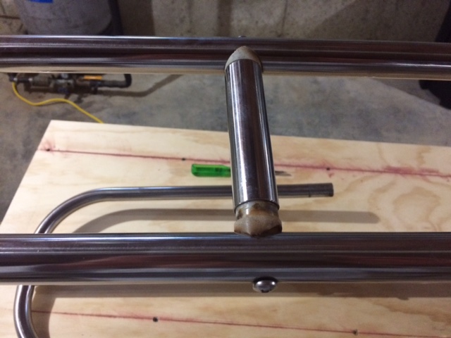

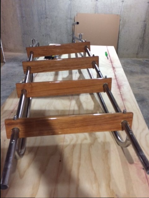

    Hi All
    Had to take the fly bridge ladder down to start getting ready to fix a few things over the winter.
    While I have it down, I wanted to fix a few of the plastic fasteners / brackets which hold the tubing together. (See photos)
    I realize this is likely a rookie question, but I cannot figure out the name of them and cannot seem to figure it out via google searches.
    Any help on the name and where to buy them new would be great ! Thanks Ladder Part.jpg ladder.jpg

  4. chesapeake46
    chesapeake46 Senior Member
    Jul 26, 2009
    1,781
    I got mine from an RV store on line.
    I could only find them in black.
    They are a two piece anchoring device, if you don't already know that.
    I had to re-use the inner piece that expands when you tighten the screw.
    I also painted some flat black and they look like new.
    If you loosen the 1/4-20 bolt on the top and then tap it with a hammer, the expandable insert will pop and it will be easier to remove.
    http://www.factoryrvsurplus.com/products.php?product_id=2006

  6. Tommy Rice
    Tommy Rice Member
    Feb 8, 2015
    30
    Panama City Florida
    They are Radius Tube Connectors
