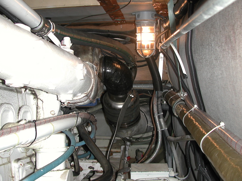

    Gen exhaust - either marine rated exhaust hose or fire retardent marine fiberglass exhaust pipe.
    My gen sat in front of the port engine. I ran a short rubber hose up and back to a long piece of fiberglass pipe. Straight run, sloped down and terminated to a fiber glass "saddle" fitting that I epoxied to the top of the port fiberglass exhaust pipe.
    In this picture it is the light brown pipe on the right. It was also translucent, so I could see the water flowing through the pipe.

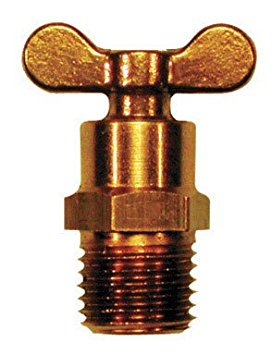

    I do agree with pulling and throwing away the factory type petcocks. Even if they did drain satisfactorily sooner or later the handle will break off.
    Use either solid brass plug or all brass-bronze petcocks.
    Completely removing the petcock allows any crud they may be built up behind to drain.
    You will have at the minimum, drains on the water pump, outlet elbow, heat exchanger and oil cooler. You may also have a drain on the blower side towards the rear.
    This type allows complete removal of the actual stopper.
    On the closed cooling system (antifreeze side) solid plugs work because you will infrequently be draining the system.
    On the raw water side, a petcock in the 1/4" pipe areas and solid plugs on the 1/8" holes
