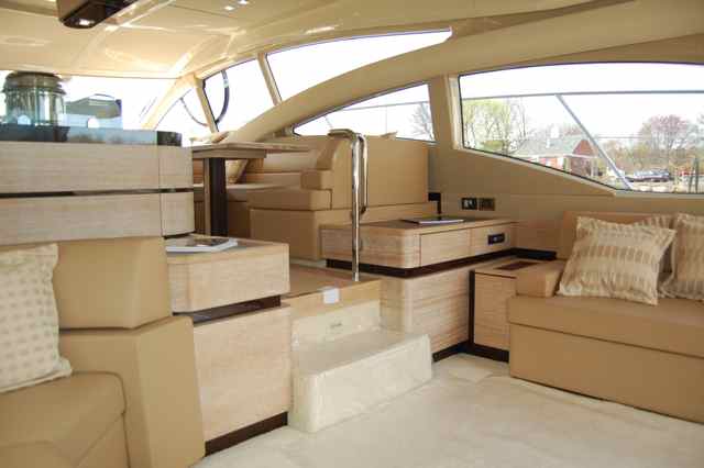

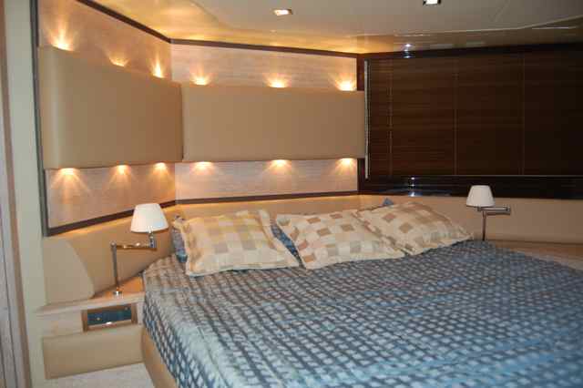

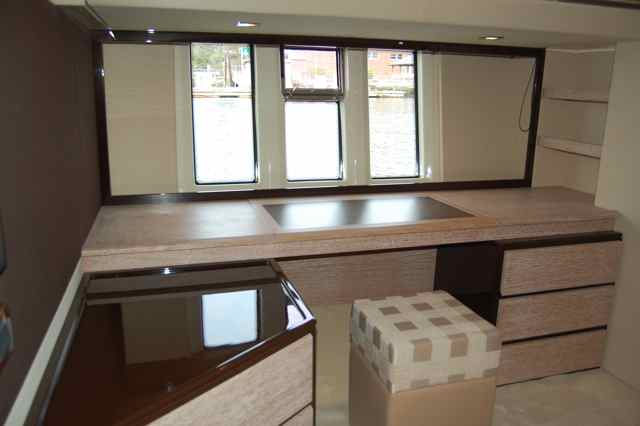

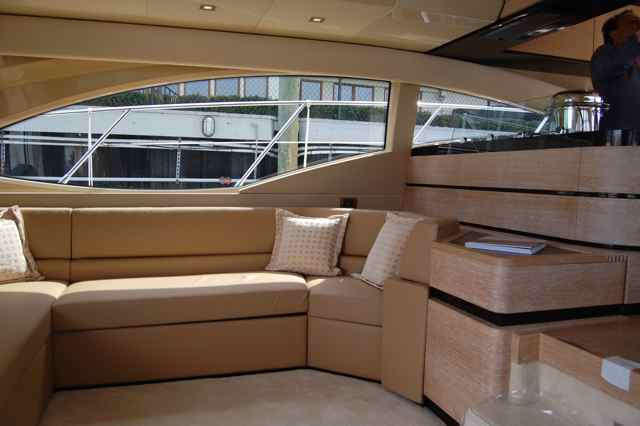

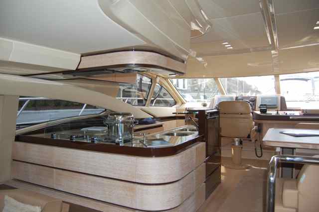

    I am trying to distinguish between fact or fiction when it comes to the quality of a particular Euro cruiser. What I am looking for are objective opinions on the new Azimut 58, or for that matter any Azimut in that 50' to 60' range. Many stories have been told about Azimut nightmares. But how many of the nightmares were caused by the builder and how many were caused by poor dealer service and follow thru? I am concerned with design, fit and finish, quality of construction and materials. Many of us can say that they are pretty boats but are they good boats. I spent sometime this past weekend viewing and sea trialing a new Azimut 58. Ascetically, she is beautiful, but when opening drawers many of the insides were not wood. The sides seemed to screwed and glued, box style. Not the dovetail you see in other boats in this price range, especially some of the Taiwanese boats.

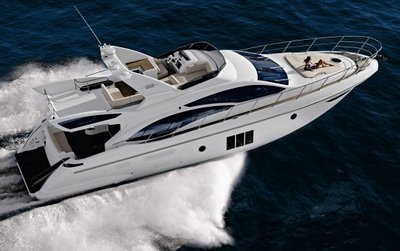

    A Running Shot
