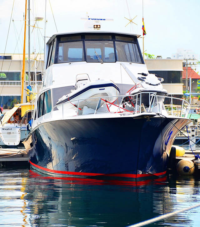

    I don't fill the tanks all the way because of some leaking at higher levels. I gotta get that fixed. I'll try adding some weight on the stern this weekend to se how she behaves.

    I really hate to point out the obvious here to the OP, but why in God's name did you not sea trial the boat before buying it? Could have saved you a lot of time and aggravation....and buyers remorse. Personally, I won't sea trial a boat in anything less than 6 to 8 foot seas. Just about any boat will run good in a 1-2 foot chop.

    I don`t carry a lot of fuel because of leaks in the tanks at higher levels. I know that carrying those toys on the bow might be a bit too much, but having them when you`re at a remote beach makes all the difference in how much fun you can have. I`ll just add more weight on the stern and that should help with the issue....

    I did trial it. I think the problem has more to do with the fact that I added some toys on the foredeck plus I can`t fill the fuel tanks very much because of leaks. I posted this thread mostly to get a little insight on sport fish boats, which I`m new to. P.S. I got this boat for REAL cheap and the engines are great, so overall it was a great buy from my perspective.

    Wow look at that water line. Seems he is using a lot of the bow's buoyancy already, so he really must "plow" with a following sea. Take the stuff off the bow and go for a sea trial ?

    Let me make sure I'm reading this correctly.
    Purchased the boat with leaking fuel tanks. Added the stuff forward and did not fix the tanks?
    AND, nobody noticed the ships trim change significantly dockside?
    That is a beautiful looking ship though.

    thanks. Replacing the tanks is not an easy job. Will probably do it on next dry dock in about a year. For the moment, I can do with the small leaks. Somedy else has a Thread about this issue with the tanks on ocean yachts, so I guess it's a common problem. That pic was taken with very little fuel or weight on the stern. She usually isn't down by the head like that. Like I said, I'm aware of the weight distribution issue, I was more interested in getting some insight from people with experience with ocean boats and SF boats in general, so I could determine how much of the yawing issue was due tu hull design rather than weight distribution. I have already added more weight on the stern and will be trialing the boat soon.
    No experience with Oceans. My 30 ton Post 50 does just fine in following seas, but I run ahead of them, if they are to big for me to do that I stay home. The earlier Post 42 and 46 were squirrely in a following, but there were some design changes that fixed that. Maybe someone else knows what they were. That SS40 increased his rudder size? Good luck. Good looking vessel.

    SMR- Your boat is very bow heavy from the pic. Honestly, when you do your fuel tanks, I would replace them with exactly what is in there, not the hokey 3 fuel tanks plumbed together that you were planning, even though it is quite a lot of work to do that. I would say about 40-50% is the boat design. The rest is the weight distribution due to the low fuel, dinghies and etc. To help short term you can fill the livewell and fishboxes with saltwater from the washdown pump, or even just to go on a sea-trial and try it, Also if you want to rule everything you've added from the equation, dump the toys in the water and seatrial the boat with fishboxes full of water and no toys on the bow and you'll know what your baseline is. Motoryachts due this also if you screw up the trim too much.
