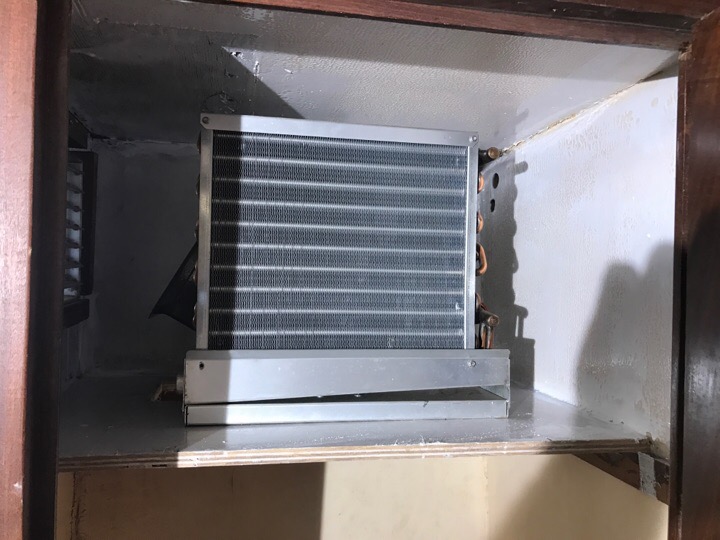

    I have had a lot of trouble with drain hoses on A/C air handler units. I have heard several theories about how to keep the hoses clean, compressed air from unit, vacuum from the drain end of the hoses, etc. I would appreciate any suggestions from people who have had success in this area.

    The problem is that the **** boat builders and installers dont use big enough hoses and worst run them without enough slope to drain. It drives me nuts... almost every boat I ve owned or run had the problem on at least one or two air handlers
    Wet carpets, drips from the ceiling... lovely.
    And to make things worst the drain holes in the pans are usually impossible to reach because the evaporator blocks the way.
    That said what I do is stuff a flexible hose in the pan hole with some shop towel to seal and blow thru it Cruisair pans have 2 holes often teed together so you need to block the second hole when blowing
    The best air handlers I ve seen so far are from Flagship marine. They built them with a slope in the pan and use larger fittings. I ve just redone my 53 hatt with 2 chillers and 5 air handlers from flagship and made sure the hoses have enough angle
