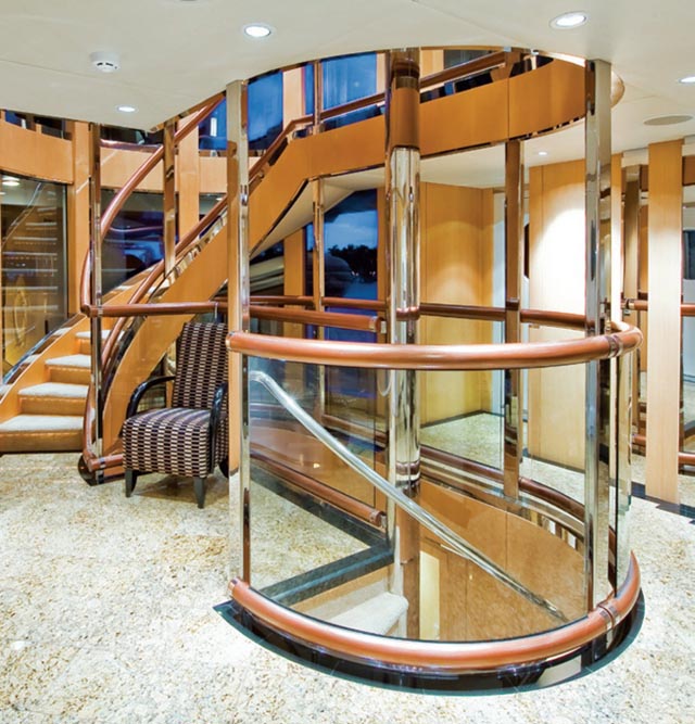

    I had the opportunity to tour Triumphant Lady at the 2016 Palm Beach Show. It's been around South Florida forever. Always wanted to see this boat. As CaptHolli said, only a handful were built by Sterling. At the time, they were the largest FRP hull ever built. I recall the upper deck resembling a strip club, but it had a very contemporary stairwell/atrium with expansive views (pic below). Most memorable was the engine room, which had just been refit and had a custom lighting system to create a disco-like environment (in the engine room !)
